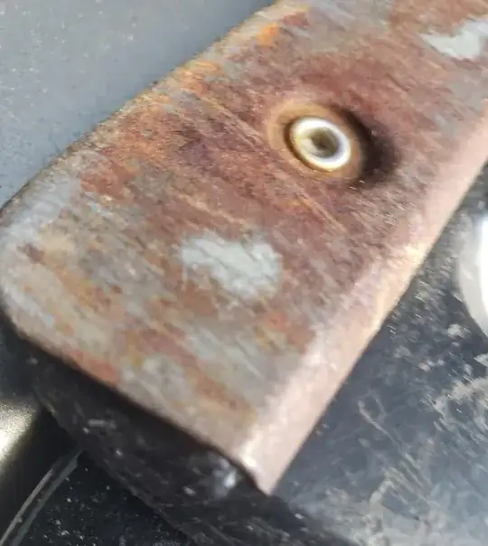

Here is a picture of my actual shovel.
The wear bar is about 1/8 inch, and it's steel. But some interesting features:
  1. It is indented (as though countersunk, but bent not drilled) so the rivets are inset on the underside. The bar can wear through entirely to the plastic without the rivets wearing at all.
  2. It has a lip, and the plastic shovel has a corresponding ridge, along its back edge. I do not understand why.
