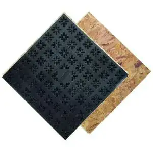

I am a big fan of DriCore. These are interlocking tiles, about 2ft on a side that combine a moisture barrier and a particle board surface as a subfloor.
dricore
The barrier is a waffled plastic that actually lets any free moisture be exposed to air to dry out. It is a bit thicker than 3/4 but adds more opportunity to solve any residual mositer problem.
I would also pre treat the floor with a Drylock type waterproof paint before installing the DriCore.
