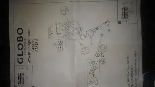

I hooked up the wire that tested hot to the L in the scheme below (brown lamp wires) and one of the other wires to N (blue lamp wires). When i flip the right switch, the lamp works as expected.
However when i tested the L, Ground, and N sockets/ports, when the switch is OFF, all of them caused the phase meter to light up. Any metal parts on the lamp body itself also cause the screwdriver phase meter to light up.
Will i cause fire and/or death to whoever touches the lamp while changing bulbs?
lamb body schematic

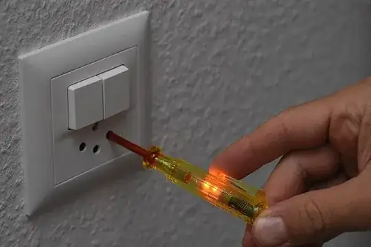

I'm guessing you used one of these: Neon test screwdriver By Simon A. Eugster - Own work, CC BY-SA 4.0
They indicate at sub-mA levels of current. Wires tend to stay parallel for some distance, which means there's capacitive coupling between them. This induces a small current in them, which can be quite high voltage - but almost zero current.
To prove that a circuit is dead, you have to measure with a load on it in such cases. Such a load may be a light bulb, or a measurement device with low impedance. Some multimeters have a low impedance mode to allow such measurements.
In short, you should throw away your neon indicator screwdriver. It's next to useless, and may actually be dangerous in some scenarios as it doesn't provide complete insulation between input and output.
Get a real multimeter, and measure actual voltages with a load in the circuit. 230V is not dangerous or a real fire hazard if the current is 0.1mA, but 10V is a fire hazard if the current is 1A.
