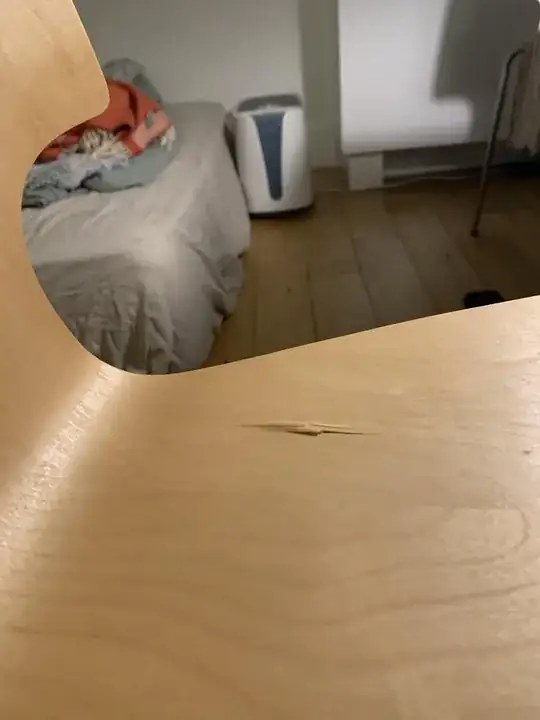

I mistakenly used a longer screw to my chair when I assembled the legs and messed up my chair. I attached some photos and what do you think I should do? I'm considering to buy the cushion but I'm worried this will further break my chair. I guess I could glue it carefully? But it's pretty hard to press the wood back to its original place just by hand at the moment. It's birch wood.

Get some glue (make sure to use a glue rated for wood) into the crevices then using a hammer and punch (or drift - a soft one unless you are gentle with a steel one) force the bits back down.
Wipe off the excess glue and cover with a piece of paper then clamp or weight the area so it does not lift.
Once dry, sand as needed then re-finish.
