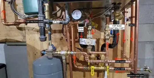

Last month we installed a Lochinvar NKC199N, using LP Gas. Attached is a picture here for the reference. We have 4 zones, but let's forget about the other 3 zones as I am having issue with one zone that we use to heat the radiant concrete slab.
The radiant concrete slab
We set the outlet water temperature from boiler to 120F, it is sent into the slab and comes out at around ~100F which is perfect, but when the return water get back into the boiler it raises up to ~116F as seen in the LCD display of Lochinvar.
I don't understand why 116F water returns to the boiler? So we only get 4F delta instead of 20F delta from the actual radiant loop. And when I touch the boiler inlet, it is as hot as the boiler outlet. So it makes me think the boiler inlet is actually pulling hot water from boiler outlet because of they are connected through that manifold.
So my questions are:
  • Why we need that mixing manifold?
  • Why does boiler inlet pull hot water from outlet? Do I need a strong pump at the supply side?
Note: since I've mentioned early that I have 4 zones, when all the zones running at the same time, I did see the return water temperature closely matches with boiler inlet, made me think the more pumps running actually force the water back into boiler inlet with the expect temperature. Is my radiant floor circulation pump too weak to push water back? (They're all brand new pumps)
