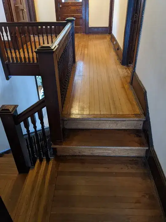

This is a 100-year-old, single family house in Washington, D.C. The floors are aged and worst of all terribly squeaky. The main issue we are trying to solve is to not have the floors squeak.
Unless we hear better advice here, I assume this means replacing the floors. As was typical for houses during this period, the second floor hardwood is installed directly on the floor joists - no subfloor. (On the first floor, there is subfloor made of diagonally running 3/4" boards with 1/4" finish parquet floors nailed to it.)
We are considering replacing the floor "in-kind" - removing existing trim, finding 3/4" tongue and groove long boards and installing directly onto floor joists, room by room.
Clearly this is not how it is done nowadays, but installing subfloor is a much bigger job since the only way to do it well is to remove the stair railing, otherwise the new floor will be 3/4" higher, plus this messes with the height of the first and last step on the stair run (first step riser 3/4 shorter, while the last step is 3/4 higher).

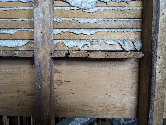

To give my summary on the idea of floor replacement, and using the second picture in your showing the ledger, floor ends and plaster, shows the house is constructed using the "balloon framing" technique used at the time your home was built. That being said, and knowing how the homes of that era are built, replacing the floor outright will definitely have a lot of "gotchas".
Just like the picture, the outside walls are built with studs going from bottom sill plate at the foundation to attic top plate, usually with continuous studs, sometimes with lengths up to 20 feet long or longer (wood was plentiful back then). These are the only walls that are done this way.... typically... there may be exceptions, but that mostly happens at stairwells. In order to work at the second floor level. The finish floor was run over the entire second floor and the interior partitions were built directly onto the finish floor. This practice would make it really risky cutting up the old flooring, since many of the walls will have its support cut out from around the them. This is the "gotcha". All you would need is one wall to set on the flooring only and it would make the whole process impractical.
So with this in mind, it seems the only option is to better fix in place the flooring you have.
