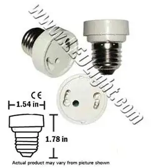

Also, you can get Edison to GU24 adapters, which means even if Edison bulbs themselves disappear, you can still use your existing fixtures.
Edison to GU24

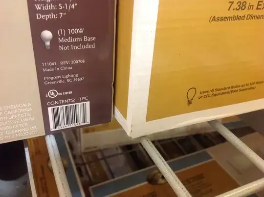

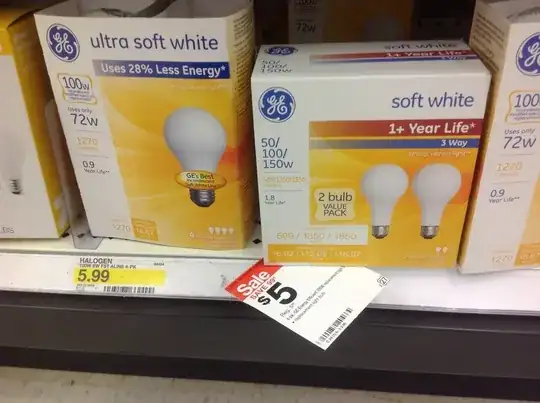

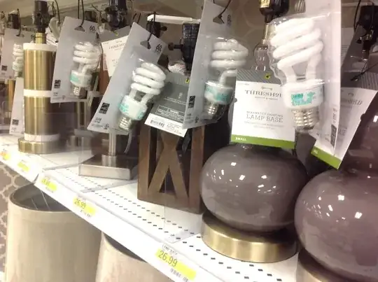

Five years gone, here's the situation in America today: March 2016. Or rather, shops near Berkeley, California, which had a big hand in development of the CFL.
Target. Incandescent bulbs (tweaked to be somewhat more efficient with halogens and high-temp inner bulbs) are readily available, four for $5. Pretty close to the old 1980s price for quality plain bulbs, adjusted for inflation.
Target. Every fixture has an Edison E26 base, there are no GU24 fixtures in the store. Note they give you a free CFL with each fixture.
Home Depot. Every fixture is Edison or candleabra. Could not find any GU24s. They do not supply bulbs, and boxes talk like incandescents are normal, some acknowledge CFLs but have never heard of LEDs.
