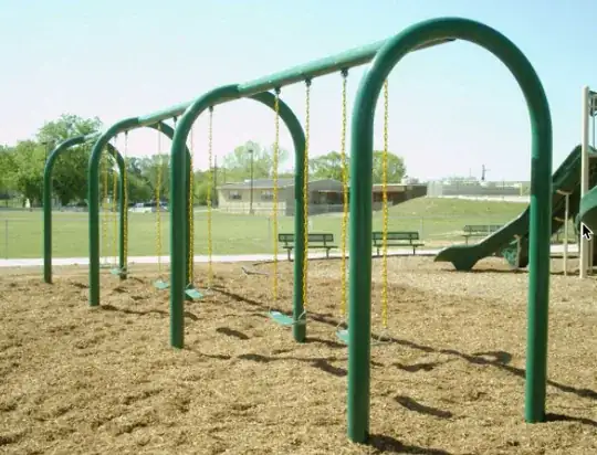

IF I wanted a set that is entirely swings (no fort, ladder, etc ... all swings) and for five people (five all swinging at once) I would not do this!. I would purchase a commercial steel set and pour heavy concrete anchors for it.
Even this extremely robust one does not rely on 4 legs and a single span for five swings. And I have no doubt the main beam is strong enough. There are other reasons that this one uses multiple sets of legs and shorter spans.
