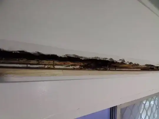

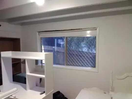

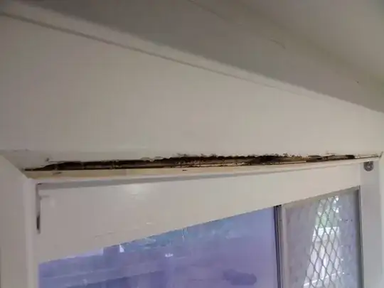

There is some not-so-small amount of rainwater entering our basement from the top of a window. I have checked the roof and gutters and fixed all cracks in the mortar between bricks on the exterior wall. I have also sealed around the window carefully. I can't find where the water can get through. The problem seems to be an old one as some timbers around the window frame have rotted.

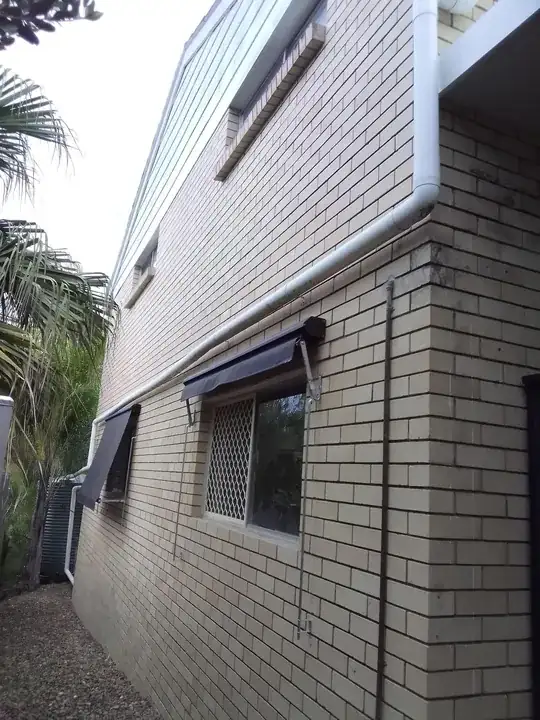

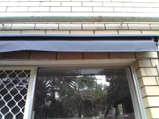

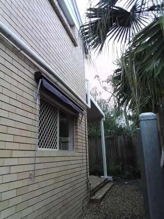

The house is built in early 1970s, I don't see any weep-hole anywhere on the wall, and we never get snow or icing conditions. Here are some photos from outside and inside:

Bricks are porous. A single layer is called “brick veneer”. Brick veneer is installed on a structural back wall.
Usually it’s a wood frame wall with a moisture barrier applied to a layer of plywood. This moisture barrier is sealed at the bottom AND the bricks have “weep holes“ to allow the moisture to drain out. Weep holes are merely spaces in the vertical mortar joints at about 24” on center horizontally with no mortar.
Make sure the opening is clear, but don’t scratch the moisture barrier… often times the moisture barrier extends into and through the weep hole opening.
Often those single wythe bricks are painted to try and reduce the amount of moisture that penetrates the wall. (They make a clear coating too, if you want to keep the brick look.)
And that is quite likely the source of your leak. It's not the brick that the "not-so-small" amount of water is seeping past, it's getting in through the rotten wood.
I'd suggest looking into replacing the window frame and/or the whole window.

If your house has gutters on the roof, and they are some distance away from the wall, then they form a sort of "umbrella" to stop rain running down the brickwork. Of course, if the wind blows, then rain can be pushed against the brickwork - generally the further down the house, the more is likely to be blown against the bricks.
Bricks are porous, but they're unlikely to pass water through them in any sort of quantity. What they will do is soak up water and hold on to it - that's more what you'd describe as "moisture" or "damp" and will quite happily rot woodwork (quite quickly) if it is in close proximity. There are paints and coatings to try to "seal up" brickwork to lessen their porousness, they have variable benefit though.
As identified, a double-skin of brick (with a gap between) allows any moisture or condensation on the outer skin to simply fall down the cavity to be drained away. On a single-skin brick wall, it's unlikely the inner surface of the bricks has been plastered and decorated into the room. It's more likely you have a layer of something (eg. stud wall or similar), which performs the same function as the inner layer of bricks in a double-skinned wall. In some situations, the outer bricks above a window have "weep holes" to let any water that may be pooling to dribble out.
If your windows frames are rotten, then they're most likely now even more porous than the brick - you can't paint over them to protect them, you'll need to replace the wood. You can (to some extent) do this by chipping out the obviously wet wood, drying the remainder (perhaps after a warm, sunny week) and then putting in filler. Once that's all hardened, paint it all thoroughly. In my experience, such a repair will likely only last a year or two - replacing the frames entirely is the "real" solution. When you do replace them, you can see if there's any sort of moisture barrier across the top of the frame - if there is, then it probably has holes in it, but it's there to stop the water getting into the frames, and hopefully would let water drain out of weep holes (if you have them, or will have them).

EDIT: As you've now added some pictures, whilst it's hard to tell, you have what I'd describe as "deep pointing". That is, there's a little space between the edge of the brick and the start of the pointing. There's nothing wrong with this, but it may mean that you have a little "shelf" for rain to accumulate on - and it then be able to seep through the pointing.
It's not a nice job, but after some rain, if things seem wetter than usual, then have a run around the pointing with the end of a screwdriver or something and see if there's any soft pointing. Don't hack away at it, but just see if there's any pointing that's a bit soft and comes away easily (ie. it's a bit like compacted wet sand). If there is, then it may be letting water through.
