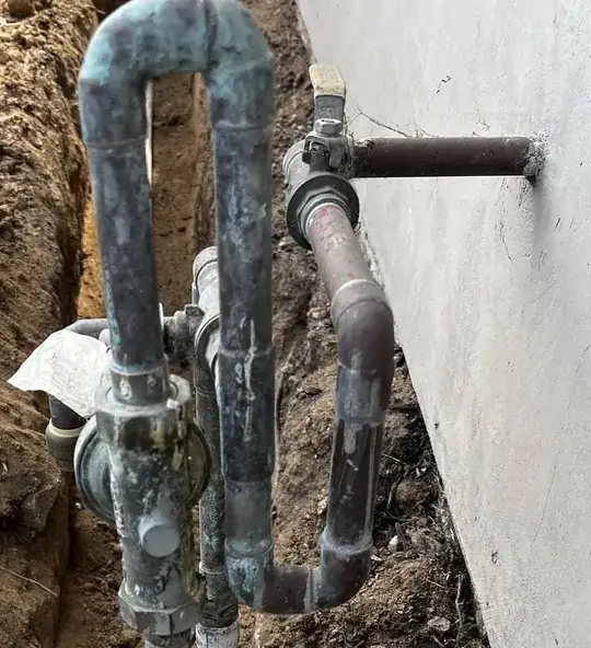

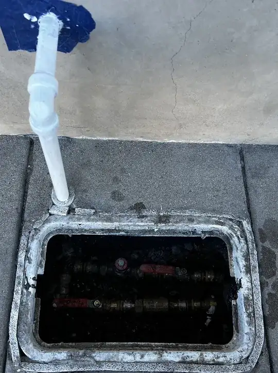

I also removed what I would best call an S-curve in the copper pipe after the pressure regulator and before entering the house. I had googled it and couldn't find anything about why it was there but maybe it acted as an air chamber - not sure. I removed it since it seemed unnecessary and only there to line up the pipes. This then let me put the whole unsightly assembly in a valve box underground. Here's a pic of the before:

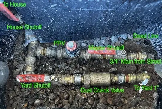

And after:
Water comes up on the right, into a ball valve, into the pressure regulating valve (PRV), then tees up to the house via ball valve, and down to my yard's irrigation / hose system after a dual check valve. There are pressure vacuum breakers before the sprinklers.
Now, when either the master shower is turned on on the second floor or the hose is run from the end of my irrigation line, the pipes in the opposite end of the house on the first floor (near where the water enters the house) start to vibrate / chatter and make a lot of noise. I have just discovered that the noise seems to be coming from where the main takes a 90-degree elbow and moves into my main shutoff valve and the PRV. Please see the Youtube video of the vibrating here and see it in more of a closeup with a focus on the the vibrating stopping and starting here.

As suggested below, I tried slightly closing the valves, but that didn't seem to do much. I then tried to adjust the pressure bolt on the PRV and it seemed to work for when the hose was on. I tightened the bolt until the vibrating stopped, but then when the irrigation kicked on it starting vibrating again. So, I adjusted it again and this setting only stopped the vibrating when both the hose and irrigation were on. I found something else my experimenting: when I turn off the valve to the house, there is no vibration at all.
I would have to guess that either the new pressure regulator valve or the removal of the S-curve is causing this. I can't tell if this qualifies as water hammer. Does that sound right and how could I stop this from happening? Would I have to re-add the S-curve and remove the valve box? Add an expansion tank? Remove the dual check valve? Better secure the pipes in the wall?

  • replace the PRV with one designed for more flow or more primary (supply side) pressure. Your PRV may be undersized.
  • replace the garden check valve with a larger model (or temporarily remove it to experiment)
  • measure and reduce the water pressure on the secondary side of the PRV. You have measured it with the old PRV, what is it with the current one? Aim for well below 60psi.

I think somewhere you have a valve fluttering: rapidly opening and closing, but perhaps not closing all the way. It might be oscillating between "more open" and "less open" and just happens to resonate in your system. The new regulator seems likely to play a part but I'm not sure this means the regulator is faulty per se.

The S-curve you removed might have been helping to suppress this condition. Whether it was just dumb luck or was an intentional fix is impossible for us to say.

Consider this example. In electronics resistance and capacitance are used to filter out voltage spikes. It could be that your s-curve was functioning as a resistor. Also a pressure tank is basically a capacitor. Another thought is your new regulator looks smaller in diameter. This might result in a hysteresis in the way it functions. A difference (gap) in the opening and closing pressure that makes it open and close rapidly. If you touch it during the "flutter" does it feel like it might be the source? Try running the shower and then slowly closed the ball valve next to the regulator until you see a slight decrease in flow. Leave it that way and see if the problem goes away. Not a real fix but you might learn something about the problem.
