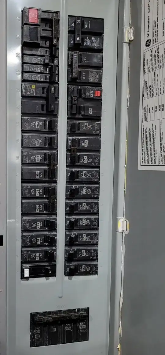

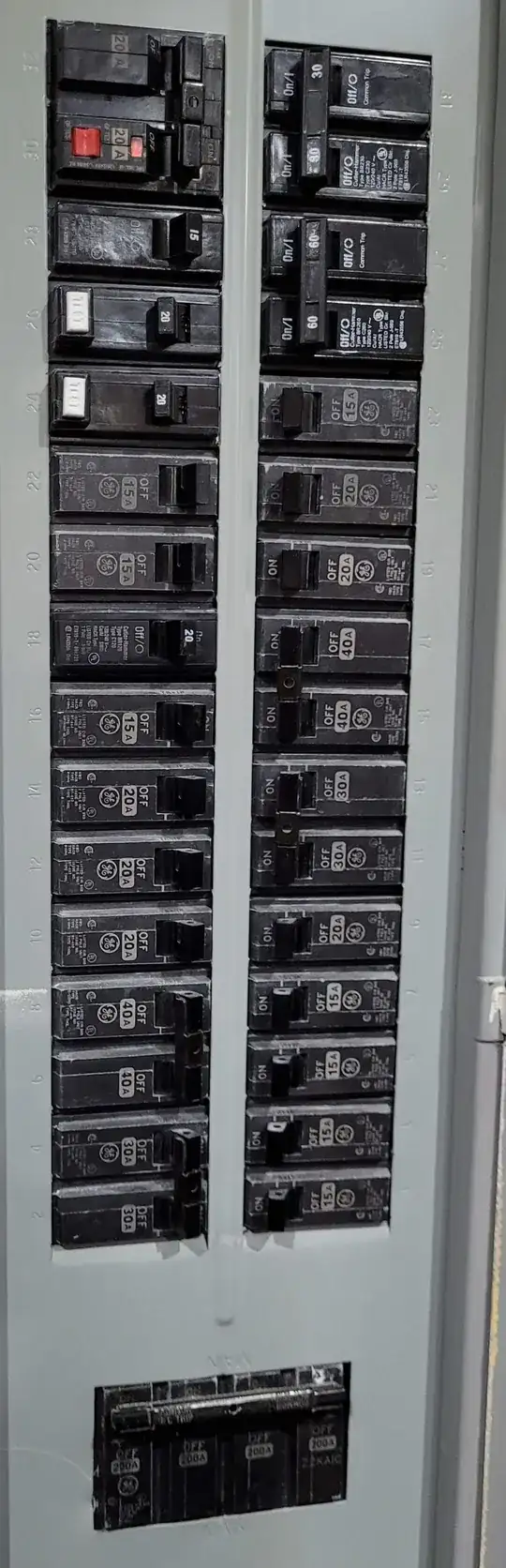

I'm following up regarding adding 50 amps to provide service to an EV charger. Crazily, I have two 200 amp service panels and both are full. As suggested in responses to an earlier post, I am attaching pictures of the panel and my recent work to map the breakers on the panel (what was labeled by the previous owner was vague/inaccurate).

Reading between the above lines and doing a lot of guessing, you probably have a large house so should factor at least 100A for lighting and general power (it's a sq ft calc you can do). Your heat and A/C seem to each require about 90A (guessing their actual load), your pool/hot tub complex seems to need about 150A. And all your special loads (steam shower, dryer, washers, sump pump, etc etc etc) also guessing their actual loads could potentially together draw another 190A.
IMO you are WAY oversubscribed already, and you cannot add an EV charger without either bringing in another service drop or installing some kind of load sharing device to share power between the EV and certain existing fixtures, eg "pool room furnace", "steam shower", etc.
I don't think your "full" panels are the main issue, you could move some stuff into a sub panel eg a bunch of lighting circuits. I think the issue is you can't add another 12kW fixed load to your service, you'll be blowing your 200A breakers.
I infer that natural gas is not available at your location, right? You might find that converting your entire pool complex to propane would be more economical than upgrading your electric service even further. Worth looking into.
