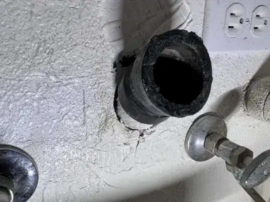

Hi guys i have a problem got a new sink and drain does not line up so had to cut back the P-trap. The drain coming from the wall is so close i didnt want to cut it. How can i reuse this fitting or should i cut it off and cut some of the wall to gain access? Let me know yiur suggestions enter image description here
Jay
You could possibly attach a Fernco coupling to what's left of that ABS fitting and then add what you need to attach to the sink. A much better solution would be to cut the rest of the fitting off and save as much of the pipe into the wall as possible. Then start from scratch, opening up a wall a bit if needed.
