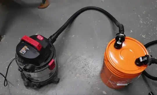

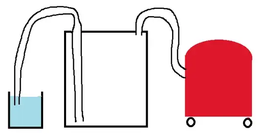

If you only have a dry capable vac you can buy or build an interim canister that traps the water
Any canister with a wall strong enough to resist being sucked flat will suffice

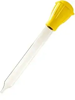

Professional plumbers, like Richard Trethewey of This Old House, use a turkey baster to remove water:
