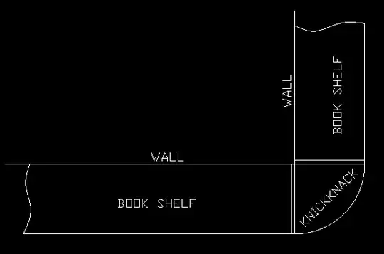

There are many ways to work out how to handle the outside corner for a built-in bookcase. One concept that I have used follows this plan:

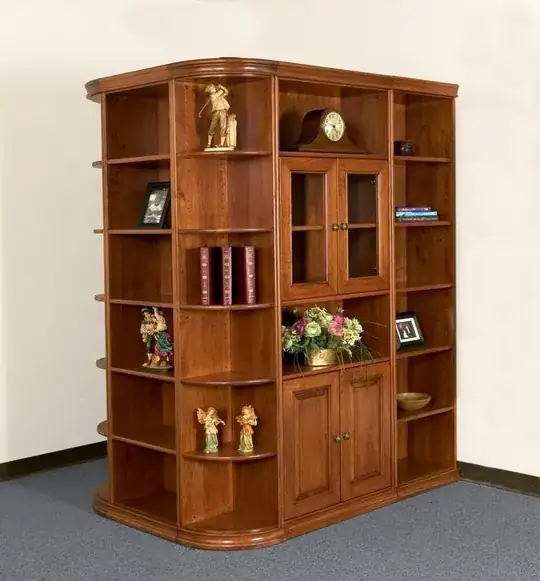

The spacing of the knickknack shelves does not necessarily need to follow that of the book shelves.
This picture will help you visualize how it can end up looking.
