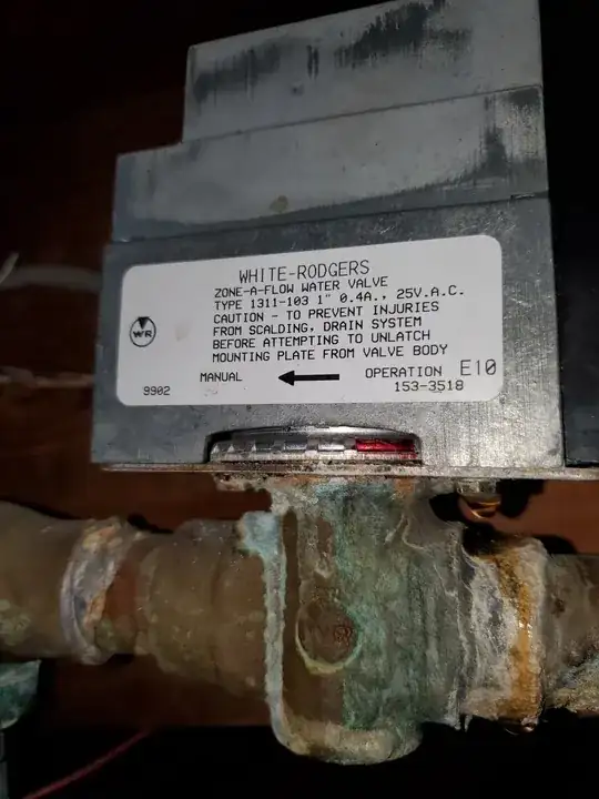

I need to replace a leaking zone valve in my basement. I think I found a replacement for it off of SupplyHouse.com but wanted to make sure it really is a suitably replacement before I pull the trigger on $150. My current White Rogers zone valve: enter image description here

My current zone valve says its rated for 24V and 0.4 amps, and the one on the site just says 25V but has no amperage rating. How can I tell whether this is a suitable replacement for my current zone valve, and (besides voltage and amps) are there any other metrics that determine compatibility (PSI, etc.)?

For the given valve the obvious specs are that it's a 1" valve, appears to be sweated/soldered to the piping, is operated with 25 V AC (nominal), and draws about 0.4 A. For a residential probably-not-carefully-engineered system that's probably about all the detail we need for choosing a replacement.
The part you linked at SupplyHouse is a 3/4" valve but otherwise similar (24 V is close enough to 25 V, amperage is about the same, etc). They do list an 1311-103 part as well, which appears to be a direct match to the one you have now.
