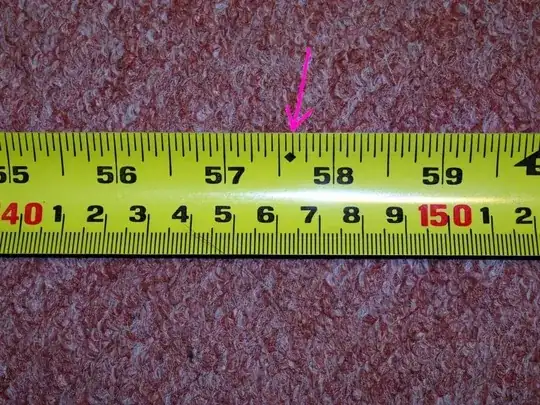

Not a very important question, but I'm wondering what the little diamonds are on my tape measure. It's a Stanley Fatmax from the UK © 2011. The first one is at ~488 mm (~19.2 inch), and then every ~488 mm after that along the tape, but they don't align with any regular measurement in can fathom.

It is an alternative framing spacing, used for studs, joists and rafters. It is an "identifier" for a stud layout much like the 16" center layout where you will get an even amount of spaces over an 8 ft. piece of material, or for that matter a 16 ft. piece of material as well.
