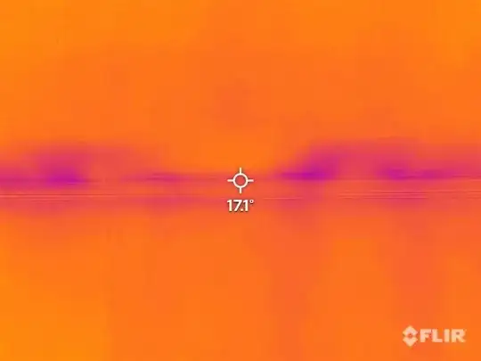

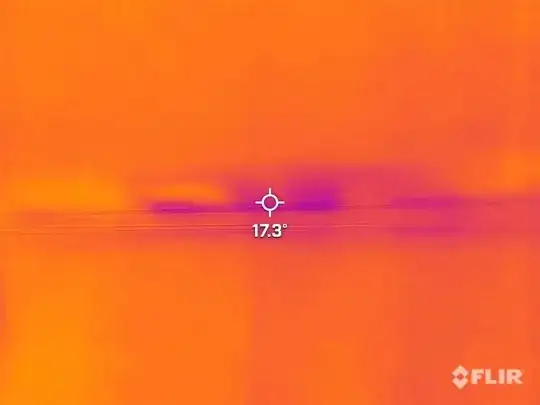

Edit: this smell REALLY reminds me of the times I have had to deal with mouse infested fiberglass. I had also been hearing scratching noises from the south facing wall, which leads up to that bedroom. The garage is underneath the wall in question, so I went to look. There is a steel beam running parallel to the wall above, but there is a gap between the wood and the beam large enough for mice to fit through. There is a lot of mouse debris in this area.
I pulled out the thermal camera and found some interesting hot/cold spots. I imagine the cold spots being where mice ripped up insulation, and the hot spots being where they are nesting.
So, I'm going to set up some mouse traps and see what happens.
