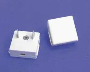

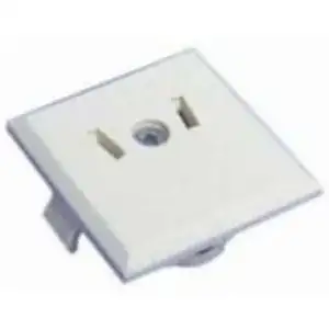

You can buy these 12volt standardised plugs and connect them up directly to 12volt. It will require a bit of DIY but you can buy blanking plates, drill the correct size hole and fit these in. But i'll tell you what. They sure are ugly and I personally would avoid them.

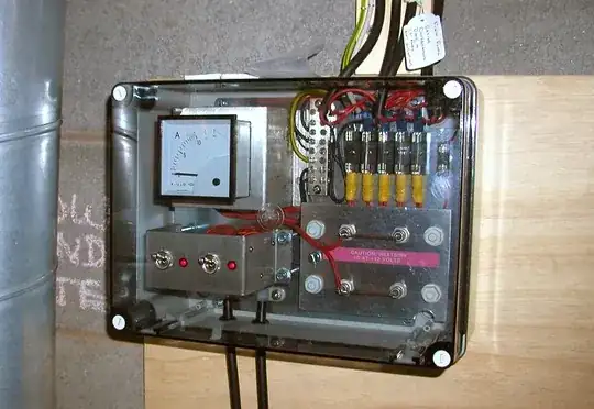

It is good idea to make a Distribution Board just like the ones used for high voltage and use circuit breakers. With cat Cable (26AWG) you want 0.3A to be safe - the rest is up to what cable you decide to run.
But even a DIY one like this will work very well and ensure safety against short circuit, over current with the ease of monitoring consumption. You can even run 110/220 into this DB and incorporate a fail over, in case your batteries run down, so you could then have a simple sensor, relay and a 12volt 2~5a power converter.

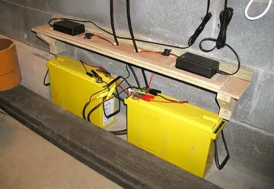

Just one thing to remember - If you are using acid batteries do not leave them on concrete! Always place them on top of timber or elevated. A strange thing happens that acid batteries discharge when placed on concrete/ground and should not be close to earth. Not sure about dry cells.

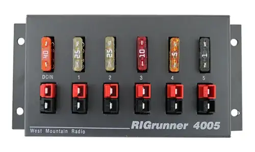

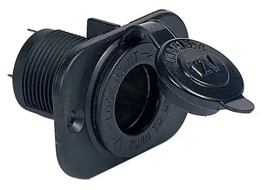

A widely-used standard for DC outlets is the "cigarette lighter" plug. If you install them in your walls, I recommend labeling each one with the max current.
Be sure to put fuses on each circuit, at your distribution block. And a master fuse as close to the battery as possible.

UK caravans and mobile homes have 12 V plugs and sockets like these. Example www caravanaccessoryshop co uk /product/2-pin-plug/1284
12V plug 12V socket
Maybe you can find similar items in the US. This isn't an advertisement, I have no connection (gratuitous pun) with the company referenced.
