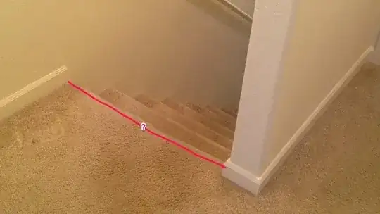

I want to replace the carpet in my bed rooms(actually the whole 2nd floor) with engineer hardwood floor. The stair is from 1st floor to 2nd floor which will keep carpet. But I can't imagine how/where I need to do the transition. I don't have any experience, appreciate if anyone can give me some suggestion.
Here is the picture of the current situation:

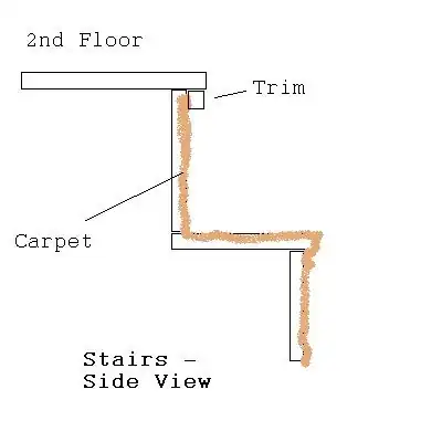

One potential location is on the last rise on the stairs. This is depicted below on my crude diagram. Make the cut of the carpet right under the lip of the top of the 2nd floor. Use a piece of trim to hide the cut and make it finished.
Location 1
Other options include:
  • Create a small carpet landing at the top.
  • Take the carpet off all the stairs and make the stairs hardwood as well.
