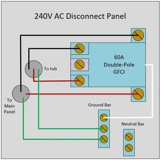

I have a strict 240V wiring situation (i.e., two hots + ground, no neutral) with a hot tub as the only load on the circuit. Now, I think it’s very prudent (and generally mandated) to have a local disconnect with a GFCI breaker...which gets tricky with no neutral.
The scenario is pretty well illustrated by this image (i.e., "Configuration 2" from this previous post)

So it got me to thinking, what exactly is wrong with “Confugration 2”??
And before there are a ton of knee-jerk "it's not code" or "you can't do it that way" responses (as in similar posts), please bear with and hear me out to help consider the best, safety-minded solution for this unique situation (i.e., the 'spirit' of the code vs. pedantry about the strict letter of the code)
  • For starters, I realize that the EGC (i.e., green 'ground wire') is never intended as a substitute or equivalent for the neutral wire and that the two should never be tied together anywhere but the main panel - not disputing that, not proposing that
  • I also get that since a GFCI breaker ‘monitors’ the current traveling through the valid conductors to infer a 'ground fault', all those conductors must be connected to/pass through the GFCI
  • And lastly, while many 240V appliances do in fact also have 120V circuitry (e.g., the clock on a stove) where the neutral is a key component and a valid conductor, in my case there is NO NEUTRAL anywhere and therefore the neutral never could/would/will be one of the valid conductors
And some validation tests show that:
  • No surprise, the GFCI won't work if the pigtail is not connected (to something) so my contention is that the GFCI must have the neutral (or something) as a proxy/reference to ground to properly function
  • And lo and behold, the normal, expected functionality is there when the pigtail is connected (gasp!) directly to the ground as depicted in the image

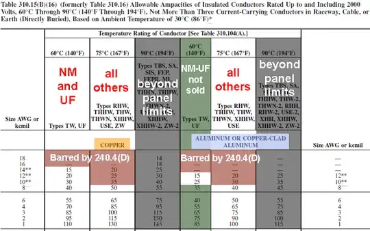

That sounds like defeatist language. In comments you say it is 3/4" EMT conduit and you have #4 in there for 60A. Let's have a look at 310.15(B)(16).
Since we're not using NM or UF, stay out of the 60C column.
There is no 60A wire, but #6 Cu is 65A (when it's not UF or NM). #4 Al is also 65A, but 3 of those won't fit in 3/4" conduit.
Three #6 Cu will fit inside 3/4" conduit with room for a bare #10 ground (if you even need that; it is EMT after all).
The problem with your question is confirmation bias. It is to your disadvantage to find the reasons. But...
When you misuse ground for neutral, it's not ground anymore - it's neutral. And now you have the same problem as 3-wire dryers and ranges. When the neutral wire breaks on those, it guarantees the chassis of equipment (in your case all grounded things locally) are energized.
Now maybe your local ground rods do their job. But then you're creating a *voltage gradient" across the earth. Metal things like fence lines can let people get shocked anyway, and the GFCI can't help here (unless it's back at the main panel).
You think the small GFCI load limits the damage? Nope. Joe Innocent comes along, aiming to add that Code-required 120V receptacle. Assumes your installation was correct and "does as the Romans do", attaching their neutral next to yours. Now you're in it!
Look, you probably need proper neutral for the 120V circuit anyway. But even if you don't, just follow ThreePhaseEel's solution -- that's tried and tested; afew years ago we had someone from the Philippines using USA equipment exactly this way. Don't even splice the neutrals to the neutral bar, you don't want someone tempted to hang a 15A socket on it. Just nut straight from transformer to GFCI pigtail.
