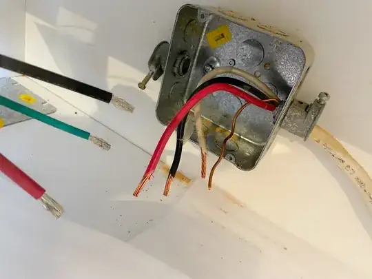

I bought a cooktop which has 3 wires:
  • Black
  • Red
  • Green
The wiring in my home is 4 wires:
  • Black
  • Red
  • White
  • Bare

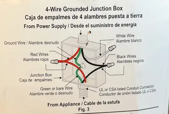

I saw the instruction for 3-wire to 4-wire connection, it states to leave the white neutral wire alone.
Is it safe to do so? Without neutral wire, how the circuit could be completed?

You go by the instructions(if listed by UL/CSA). They can override local or NEC rules usually.
If a 240volt device (stove) does not use 120 volt (clocks, fans), it does not need to have a neutral wire.
So you can cap/wire nut the neutral.

Yes it's fine.
Current flows out through one hot conductor and back through the other (with the direction reversing frequently).
Traditionally in north America it was/is common to have equipment where the high power stuff was 240V, but the controls were 120V so a neutral wire was needed, but if the equipment is designed with 240V control equipment there is no need for a neutral.
