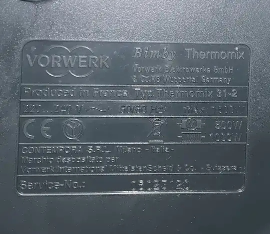

Thanks for all the answers. I did not focus on the frequency mismatch because the appliance label indicates a working range from 50 to 60 Hz, which is confirmed by my current use of it via a 110V outlet and a 3000AV step-up transformer with no detectable performance hiccup.
The label also indicates a working voltage range from 220V to 240, but I believe Simon B might be correct in thinking of this as a nominal range and adding another 10% of tolerance with respect to its center point. I guess the worst can happen would be a slower heating element and a slower motor.

Regrding the EU appliance compatibility with 208V 60Hz, check the label. Many modern appliances have universal power supplies which will work from 100V-250V on 50Hz or 60Hz. If yours is not one of those, obey the label.
If the appliance label doesn't say it can accept 208V 60Hz then purchase a new appliance. If it doesn't specify what it accepts then purchase a new appliance. As Ecnerwal mentions in his answer, pay attention to the difference between 60Hz and 50Hz as well as the voltage.

Regarding your specific appliance which seems to be a food processor with heating functionality.
Also be aware that the power output of resitive heating elements will vary significantly with supply voltage. I suspect the quoted 1000W is at 240V, at 208V that will be down to more like 750W. Not a disaster but things may well take longer to heat up then you are used to.
I would watch out for stalling of the motor. Assuming it's a mains powered motor, the motor will have less power on the lower voltage and the higher frequncy may mean it tries to spin faster (depending on what type of motor it is), this could lead to a stall which could lead to the motor overheating.
