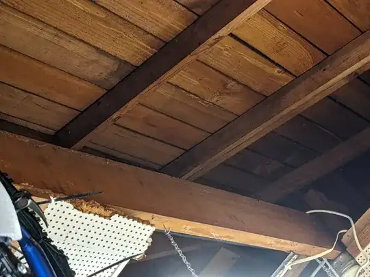

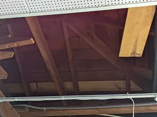

Sample photos of roof from underside; there is basically no ceiling - some junky ceiling tiles have been added in a few sections, but most is open from concrete slab to roof underside.

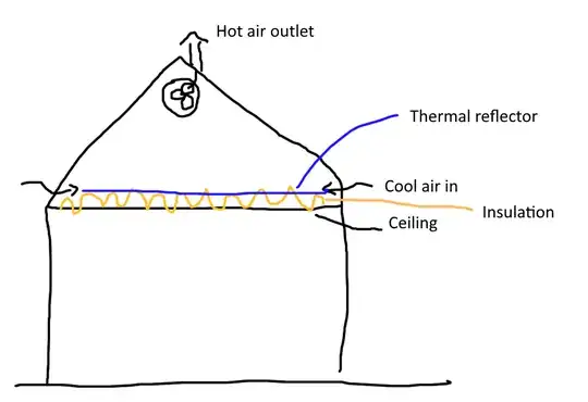

Then you can put in a ceiling with insulation and a thermal radiative reflector on top, for example metallized mylar.

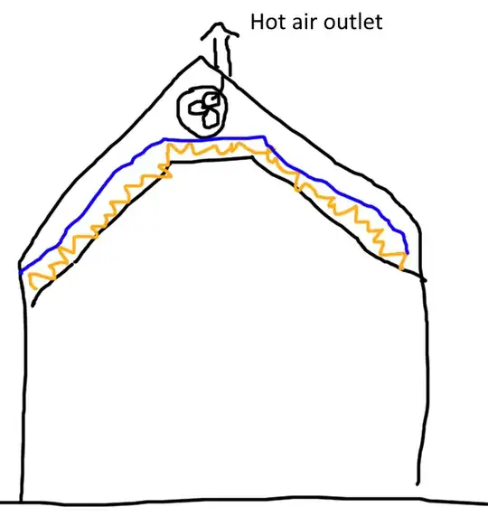

If you want a higher ceiling, you can just ventilate the space between the rafters. It's a bit more complicated to do:
Without ventilation, temperature above your insulation will reach ridiculously high values in the summer, more than 60°C. The amount of heat that gets through insulation is proportional to temperature difference across it.
So if you have 60°C above the insulation and you want 25°C in the room, temperature difference is 35°C, and the thermal power will be the same as for heating with 25°C inside and -10°C outside.
So without ventilation, insulation alone won't help much. With a cheap air extractor, you can drop the temperature above your insulation from more than 60°C to about the same as outside air, si you gain at least 20°C. Then your insulation will be a lot more effective. You can also add an air conditioner, and it will have a lot less work to do and use much less electricity.

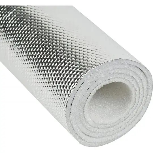

In fact, if you're okay with the inside temperature being equal to the outside temperature, there is a much simpler solution. Get some heat reflector foil, like that:

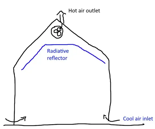

and just hang it below the rafters, for example on a simple structure you build out of wood. Then evacuate the air above it with a, air extractor, and place the cool air inlet at ground level, on the coolest side of the garage, in the shade:
Then later you can do a proper ceiling, when you have time. Of course the latest proposal is not compatible with air conditioning.
