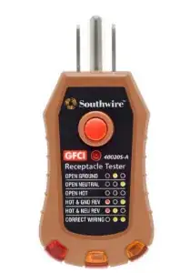

Edit: Someone asked if the box has a GFCI device. I just tested it using a receptacle tester. Nothing happens when I press the button. Receptacle is wired correctly.
