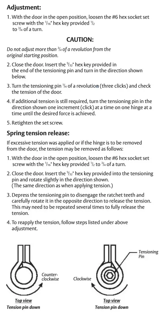

I finally found a set of official instructions for "McKinney 1500 Series Single Acting Spring Hinge for 1502, 1502TRS, 1522, 1552, 1572".
The holes with coiled metal aren't part of the adjustment mechanism. Instead, there's a 1/16" hex set screw that's only accessible with the door open. I needed to loosen that to enable the tension release feature of the 5/32" hex on top of the hinges.
Instructions for McKinney spring hinge, screenshot
