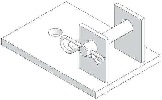

Sparr's answer is good except that I will add that you might want to consider putting legs on the bottom with a bolt and cotter pin between them. I found this picture online that is pretty close to what you will want to do.
The cotter pin can be easily removed to shorten/lengthen the chain. The bolt is smooth so there won't be friction there and allows for the chain to move back and forth between the two legs. The only pressure against the pin is horizontal and it should hold.
The pressure on the legs will be equal to the weight on the plank, so be sure to beef them up well if you intend this to hold a good deal of weight, like the weight of a person for instance.
