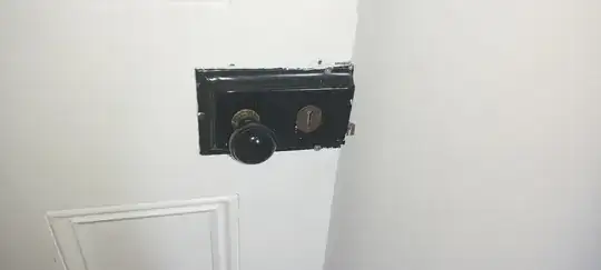

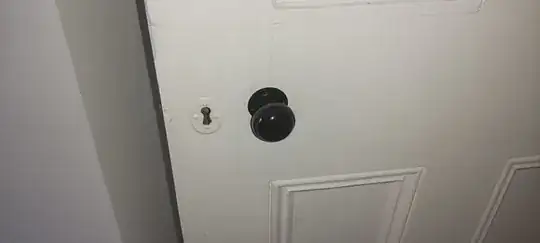

In the house I bought the doors are old but ok. However, the handle & locks are very old and we prefer to replace them. I am referring to the doors for the rooms inside the house.
Now the question is, is it possible to replace just the handle and lock or will the whole door need to be replaced including the door frame? There are 9 doors in total.
As far as I am aware, if I take the current locks off and try to put on new ones, they will not fit into the door.
And
Edit:
There are few issues that have made me ponder replacing the locks. I live in the UK.
The first is that the keys are lost. I don't know how I can get keys to fit these locks.
The second is that on most doors, the knob seems to have been "pulled out" as it is further from the door surface on most doors and feels flimsy. I feel that at some point the knob will just come off.
The third is that the doors themself have an "old" feeling to them. The doors are otherwise great. However, the scratches and dents and multiple coats of paint make them look really old.
I can consider keeping the doors as getting new ones will not be cheap. However, I need keys for the locks and also need to have a method where the door can be locked from inside without needing a key. I am trying to figure out how to do this.

If you really have your heart set on replacing the lock sets on those, I'd recommend taking the whole door off with the handle and hinge included and taking it to an architectural recycler.
As noted in a comment, these appear to be made of wide solid boards and those handle/lock sets are old and a lot of people actually like the old look. As a complete set of door and handle, they'll be worth a fair bit of money. It's hard to tell from the two small pictures, but they seem to be in pretty good shape and may well get resold with almost zero work from the recycler, so you should be able to get a fair bit of money out of them.
Once you've sold them (or at least ensured that you'll be able to sell them), go to your local big-box store and buy some cheap luan interior doors and bland, modern knob/lever sets and replace the doors. If things go well, you'll almost break even on the project, price wise.
I'd suggest calling a couple of places and asking them how they'd go about giving you an estimate on what they'll pay you for the door/lock sets. They may send someone to you to look at them and offer you cash on the spot (not so handy if they're taking the bathroom door!), or they may ask you to bring a door in so they can give you an estimate. If you need to bring one in, it should be quite simple to pull the hinge pins and put the whole door in the back of a SUV, minivan or pickup truck. (Ah! You're in the UK. You could probably easily strap it to the roof rack of a small car, or I've seen many with trailer hitches - put the door in a trailer, even if you have to hire one for the afternoon.) Just be sure to wrap it in a blanket or two to prevent damage during transport.
There's a good chance that you'll get more per door if you sell them a full set of 9 doors, than if you sell one at a time, so be sure to discuss that with them, and be prepared to live without doors in your house for a few days as you work to install the new ones.

That style of door lock is a "rim lock". You can still get them today. If they are old and worn out, go to a good hardware store, and find new replacements.
It's got to be better replacing only the locks, rather than ripping out authentic period features from your home and replacing them with cheap modern doors that won't be as good quality.

There are basically only a few different styles of lock: rim locks, locks where the cylinder is on the doorknob, and mortise locks. The builders used rim locks because the doors are thin, and rim locks are very easy to install.
You will probably have to use a rim lock anyway unless you feel like replacing all of your doors, rehanging them all, repainting, and installing new door hardware. So I'd consider shopping for rim locks, but otherwise I'd just leave them alone.

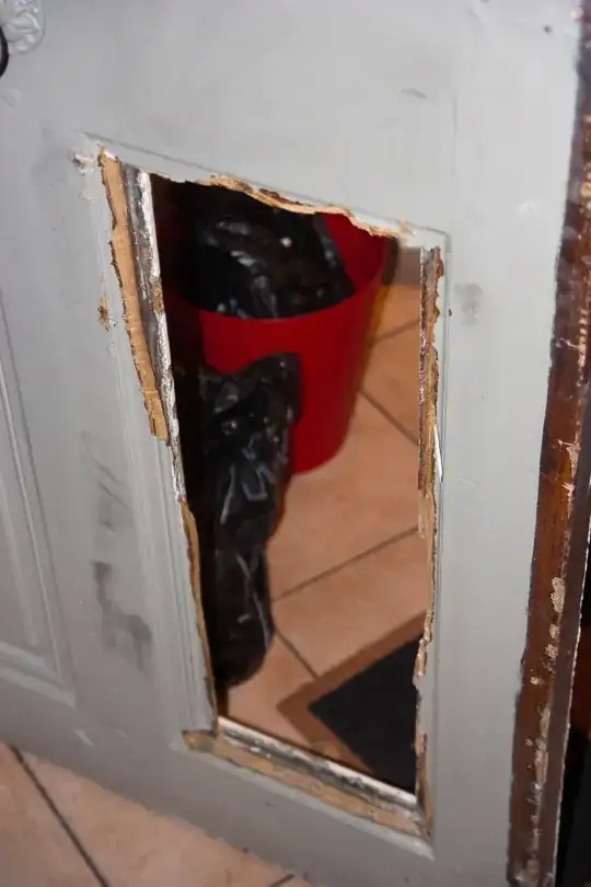

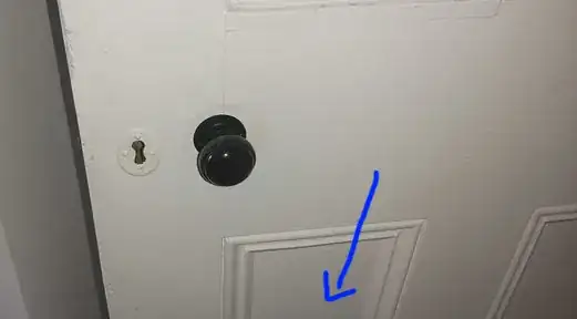

If this is an exterior door:
The problem with these old style doors is that the panels (blue arrow) are very thin. They're recessed inside the thickness of the door.
This makes them quite fragile, and they can be easily broken in a few seconds with a good kick:
After this, the burglar will grab the handle and open the door, or just crawl through the hole. In this case, it's better to change the door. It would be a waste of time and money to fit a secure lock on a door that can be broken with a kick. If it is too thin, you can resell the door and install a more modern one. In this case, the four panels are not recessed inside the thickness of the door, they're simply pieces of MDF glues on. So they stick out instead of reducing the thickness. It looks surprisingly similar.

You can fit a modern lock, but that goes inside the thickness of the door, so it requires work with a router, and it would definitely look out of place. These old doors look best with the assorted locks and knobs.
The first thing to do would be to check if the locks still work properly. If they do not, you can take them apart, clean the inside, grease it, etc. It's a pretty simple mechanism, but be careful, the spring will probably jump out at your face when you open it.
While you're at it, you can clean the lock cases and perhaps paint them, if you don't like black, or just remove the white paint stuck on the sides.
Once that's done, you can fit them back and make sure the door closes well and stays closed. This might require sanding off a few coats of paint in the hinge, or adjusting the strike with an angle grinder or file to make sure the bolt slides in nicely. This is not difficult to do, I've done it plenty of times.
If the lock is busted, you can buy new replacements with the same (or almost the same) shape, so you don't have to drill new holes.
Then replace the ugly bakelite handle with something more appropriate, and you're done.
