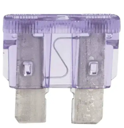

Turns out I had blown the 3-amp fuse in the air handler when installing the thermostat (I crossed some wires).
In case it helps someone in the future, the printed figure at the top is a 3 to indicate its amperage rating, not an "E" like I first thought :).
