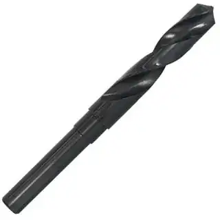

You can find reduced shank drill bits that have 3/8" size shanks for drills like yours that go up to sizes up to at least 1/2" and more. I have several drill sets that include these.
You can find these almost everywhere. Check online with this search phrase "reduced shank drill bits".
Image from Drillsandcutters.com - no endorsement implied Image from fastenal.com - no endorsement implied
