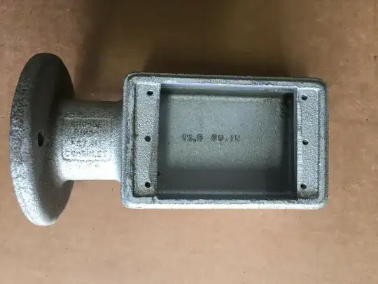

The other option is to have a box that sticks out of the work surface, supported by conduits or an integral mounting flange. While this can be done with a FSS or FDS type box and rigid conduits extending up from the floor, this is a faff, relatively speaking, and also limits what wiring methods you can use. A simpler and easier choice is to use an Eaton/Crouse-Hinds FSY box (shown below), which has an integral flange that can be screwed to the countertop, and thus is less vulnerable to mechanical damage than a FSS box while permitting a variety of wiring methods to be used to come up into it.
