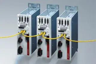

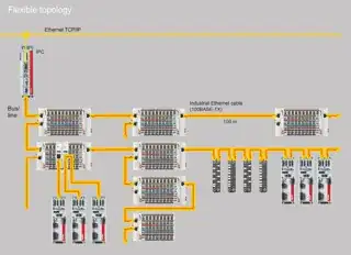

EtherCAT is a automation technology based on daisy chain and hub+spoke , as well as drop-line topology using standard ethernet technology (100BASE-TX, 1000BASE-T, and 100BASE-FX + others) .
There are a variety of PLCs , relays, I/O, bus couplers, and sensors that are available to use. Because of the topology it greatly reduces wiring requirements for automation networks. Effectively, your entire wiring topology is a single run of suitable cable snaking its way between all the devices (daisy) . For redundancy this can be doubled or split into several branches each for resiliency.
Since each segment is a bona-fide ethernet link, in a daisy chain, up to 100m/300' are allowed between nodes (and several km for fiber), so nodes beyond 100m/300' can be reached with a single cable run, assuming there are some nodes closer than 100m/300' away from each other to make the network.
Downside, as a primarily industrial technology it carries a price premium. There is a limited amount of free tools/software to work with the protocol, but it is based on standard ethernet frames.
EtherCAT Topology, source: beckhoff
Visual depiction of the topology, linking 3 nodes together (motion controllers) source: beckhoff
COI disclosure: I don't work for the non-profit ethercat technology group (ETG) or Beckhoff GMBH which develops the technology, but I have contributed to the specifications published by ETG and do have some vested interest in its long term success.
