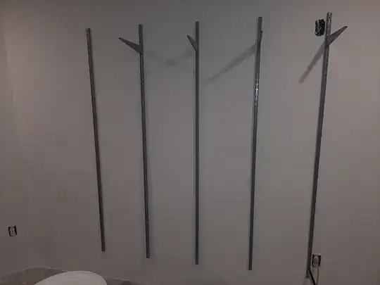

I have some adjustable wall shelves I am installing on my wall. I am using the double slotted standards and adjustable brackets. See photo of the wall standards in place. After pricing out solid walnut I learned it would cost me well over $1,500 just for solid walnut for five 1" thick boards that are 12" deep and 84" long. If I buy melamine at the dimensions I need it will cost me $90 and I can buy two 4'x8' veneer sheets of walnut for just over $200.
I thought about buying a 4'x8' piece of birch plywood that I can rip into 12" wide planks and then I'd attach my walnut veneer onto the birchwood. But there isn't any in stock at my local store. But they have melamine shelving in the exact dimensions I am looking for available which sounds a lot easier and works out to be a few dollars cheaper than buying a 4'x8' piece of birch plywood.
