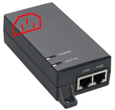

  1. A POE Injector (moderate cost for 1 or 2)
From http://gowifi.co.nz/power/active-poe-injectors/pt-pse100gf.html
A POE Injector is a box that adds the power, and has an ethernet in and out port along with a mains power lead. If you have more than 2~3 items to power then a switch might work out cheaper.

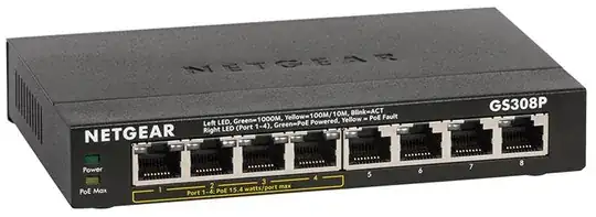

  1. POE-enabled switch (more expensive)
    This functionality can be included in an ethernet switch like a Netgear 300 Series SOHO Unmanaged Switch (model GS308P)
from https://www.netgear.com/nz/business/wired/switches/unmanaged/gs308p/
Note the one above only has 4 POE enabled ports not 8.

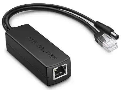

Otherwise you'll need a POE Splitter which does the same negotiation but in a separate package.
The voltage at the far end is set by the splitter, where 5V or 12V is common and sometimes has a USB micro or C plug or a barrel plug. You'll buy the splitter to suit your device's voltage requirement.

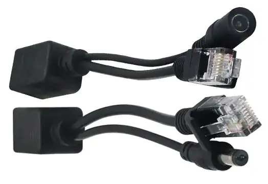

There are even cheaper "power over twisted pair" adapters or Baluns that forgo any kind of negotiation and just smash 12V onto the pairs using your existing wall PSU.
From https://www.aliexpress.com/item/4000575451173.html
Your existing PSU may not have the "oompf" to drive effectively the whole length of this "extension cable", so may not work, but they're cheap.

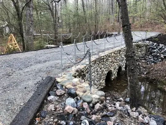

In the linked question about "solar lights in shade" POE was workable.
The building in the left of photo has AC power, bridge is under 100 metres from building. A single POE run would supply enough power to run 4x3 watt 12V LED lights, or 3x5 watt lights. Running four separate wires would allow a single 15W light on each wire and some redundancy.
