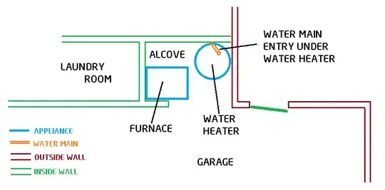

* UPDATE * I have found the water main entry point!! This was located a few weeks ago when I replaced some iron pipe risers out of the top of the water heater that had corroded so bad that a small leak had started. The gas fired water heater sits in the back corner of an alcove off the side of the garage. (The forced air furnace is also in this alcove). As you can imagine it is a rather tight fit in this alcove. I found that the water main is a 3/4" copper pipe that comes up through the concrete slab floor under the rear part of the water heater. It has an immediate 90 degree elbow that aims the water line toward an inside wall where it pokes into the wall through drywall.
Here is a rough diagram of the layout.
I will be working at opening the wall behind the water heater and installing a shut off valve there. Unfortunately it has to wait till a day when I can stay home from work and have the city utility folks come out and shut off the water main. I tried to shut off the water main with my T-bar handle but something is clearly wrong with the valve because it does not turn the water off when rotated either direction. I was able to move the valve through 90 degrees of rotation but no luck stopping the flow of the water.
