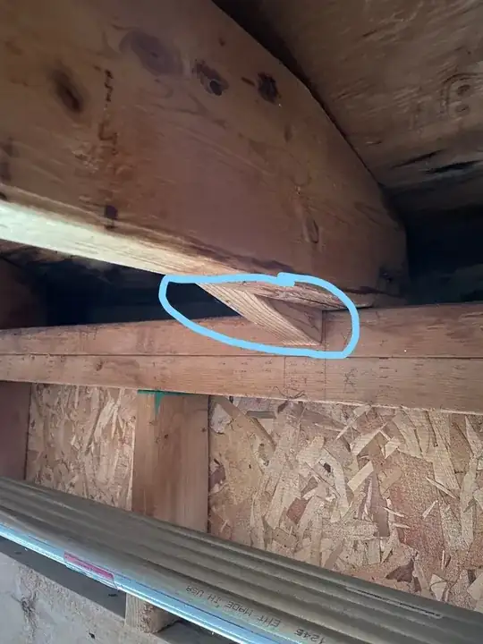

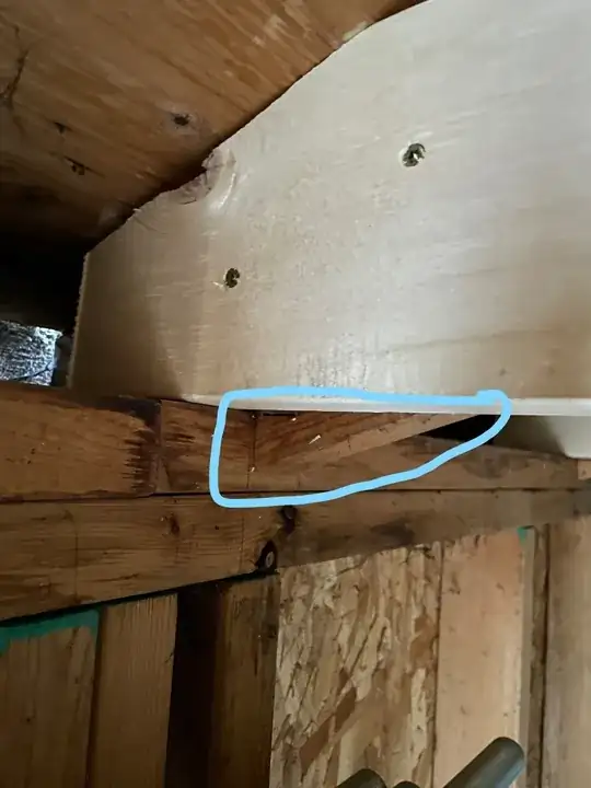

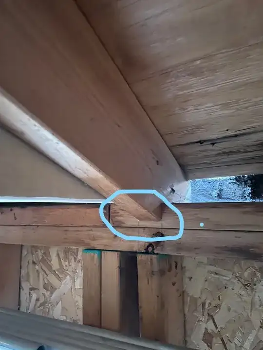

I am finishing my garage and I have come to the point I need to start drywalling. I ran into a roadblock and would like to get opinions on how to proceed. The roof is a pyramid shaped hip roof and each rafter has a small "notch" where it meets the top plate. It hangs down far enough that it would either require notching out the drywall on the ceiling and wall where they meet. This sounds like a big pain. I was wondering if it would affect the structural integrity by cutting the notch off so that I can get it flush with the ceiling joists, or if there is an easier alternative to notching the drywall. I have circled the "notch" in several photos below that I am referring too.

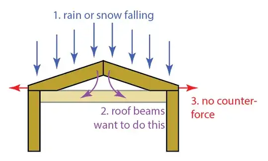

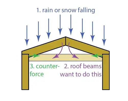

Do not remove those. That small bit of wood prevents horizontal sliding of the roof beams, and therefore roof collapse. Those two screws that attach the horizontal beam can't compensate for that if you remove them. Roofs have to deal with dynamic loads (rain, snow, wind) and under those situations they'll need to be able to carry off extra weight.
This is your current situation:
Removing those will have this effect:
Imagine standing over a wide crevice with one foot on each side, flat on the ground. Your feet want to go further sideways, and eventually you'll fall. Now imagine resting your feet against the edges of the crevice. That's far more stable.
