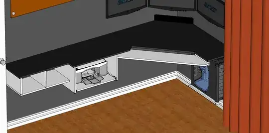

I'm looking to make a custom desk. I'm trying to decide on a material for the desk's surface. I have a fair amount of tools and am familiar/experienced in cabinet making (though it's been awhile). I have not, but probably could do laminate.
What gets me confused is the shape of my desired desk. It is roughly 4'x7' with multiple cutouts along the face. Cheaper is better, as long as it's functional and looks good. Laminate is an option, if I could face the edges well/cleanly. Something like carbon fiber or such would also work (the look, not the actual product.)
Requirements:
  • sturdy
  • able to be mounted to wall without legs
  • smooth/clean (writing surface) (will varnish if I have to, but tend to not be happy with varnish as a writing surface...too soft sometimes)
  • either modern-black or rustic-burnt wood grain
enter image description here Done in Google Sketchup. (File available upon request)

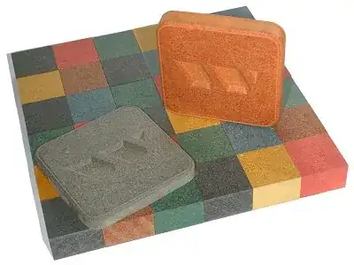

For an inexpensive and easy to work with material I would consider MDF. In particular there is coloured MDF available. The colour is throughout the board, not just painted on the surface, here's an example:
The benefit of this is that simply scratching the surface will not remove the colour. It also gives the MDF a neat texture as the colour is not 100% solid.

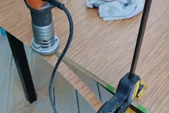

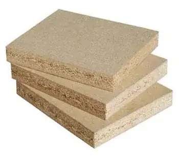

Particle board with laminate.
Cut laminate so it's a little larger, glue it on with contact cement and trim the edges with a router.
Cheap and durable.
Particle Board
Formica trimming
