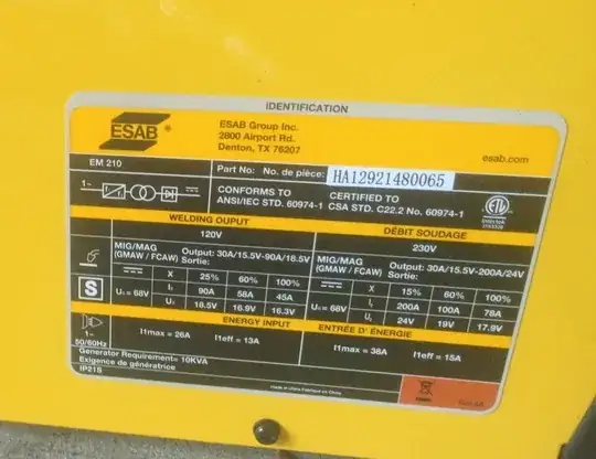

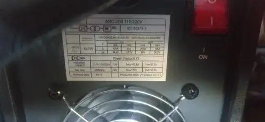

My cheap chinese inverter welder My ESAB wire welder I just got last month I am living in Ontario Canada so I am dealing with the Ontario electrical code. I am planning on installing a 240V welding receptacle in my garage. The garage subpanel is fed with a 60A 240V breaker from the main panel in our house. Both my welders pull 40A max at 240V, so to size the circuit properly I think I wire a 50A circuit so the maximum amperage is not more than 80% of rated capacity.

Edit thank you for the speedy responses folks. I will post pics of the nameplates tomorrow. Yes, welders are funky. I have a copy of the 2018 code and it only talks about transformer welders, motor-generator welders, and resistance welders.Both of mine are the inverter type. Maybe the 2021 code will mention them?

Here are the photos! The ESAB pulls 38A max and the cheap stick welder pulls 41.

I'd allocate 40A on a 50A breaker to the welder receptacle
For load calculation purposes, I would treat the welder receptacle as a 40A load. This covers both the current situation as neither of your welders has an I1eff (effective primary current) greater than 40A, and also permits the next occupant to use the receptacle for an EV charger instead. It also leaves you with 2 20A circuits of intermittent load, which is sufficient for LED lighting and a basic 120V tool circuit.
