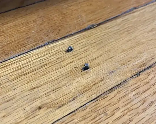

Two nails in my hardwood flooring keep popping up:
I have knocked them back in, but because of a bit of flex in the floor, they work their way back up. What should I do about them? Is it best to just pull them?

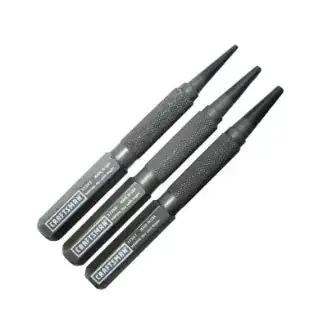

Use a nail sinker tool, so to drive the nails just below surface and not to keep banging/damaging on the floor.

    • Ideally you would use a trim nail punch to set the nails about 1mm below the surface

I'd pull them and put in a few drops of cyanoacrylate glue (AKA superglue) or epoxy in the nail hole, re-install the nails and I guarantee you won't see them pop up again! Like knowitall's suggestion to use the punches to get them slightly below the surface and fill with wood putty.
