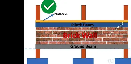

We have water percolation pits installed around the house to handle waste water from kitchen, washing machine and bathroom.
I worry whether this water percolation pit can affect the RCC column and footer which is my foundation?
The building was constructed using framed structure rather than load bearing wall structure.

Would this be a problem to footing and cause any differential settlement?

You need to lower the water table below the bearing face of the concrete footings to prevent oversaturation of the voids surrounding the soil particles which could cause soil movement and uneven settlement of the footings.
