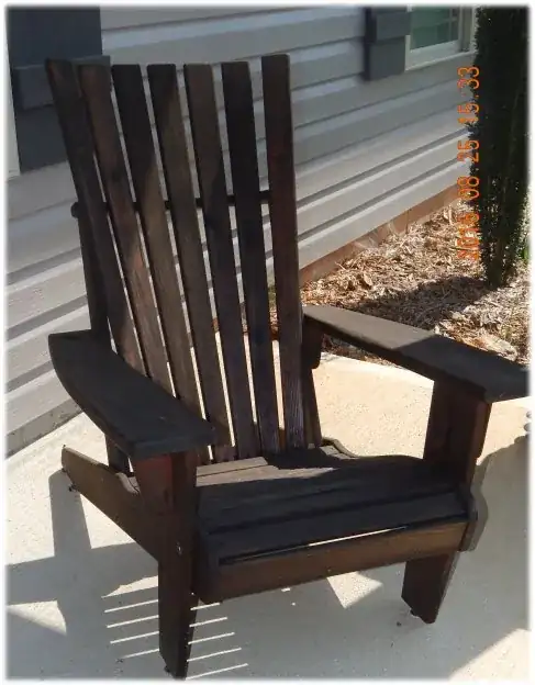

About 35 years ago, I build an Adirondack Chair using pressure treated wood. To preserve the wood I used an old farmers recipe using Linseed oil, which follows...
Apply oil, after time to soak in, wipe excess off... | Once a day for a week | Once a week for a month | Once a month for a year... | After that, as needed
My chair as I said, is about 35 years old and it has been outside since I finished the project. enter image description here
