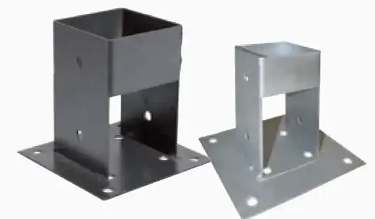

You could try using a different type of bracket, like the ones shown below.
A post bracket: a square metal bracket with some through holes, attached to a base plate
The bracket is attached to anchor bolts, either set in the concrete, or with expansion sleeves in drilled holes. The wooden post is inserted into the bracket and secured with screws or bolts. You could leave it floating an inch above the base plate to prevent rot.
There are similar ones that can be cast in place. See for instance this video at 1:20.

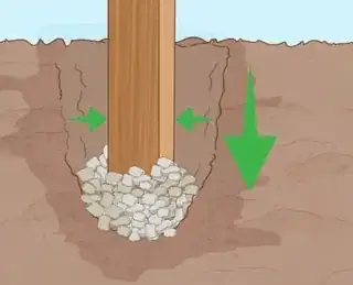

In this case how can we retard the rot? Some recommendations I have seen include:
  • placing six inches of gravel at the bottom of the post hole before pouring the concrete. Allows seepage of water How to Protect a Wooden Post from Rotting in the Ground enter image description here

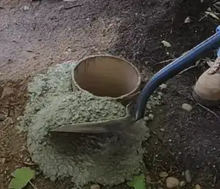

  • Using a sonatube and raising the footing several inches above grade. I am going to use an 8-inch diameter tube and do a 20 inch pour: 4 inches above grade and 16 inches below.

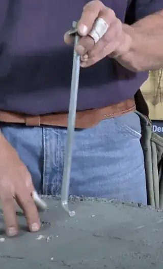

This is only a qualitative answer but I'm likely to go with it. I'm fairly convinced by this J-Bolt for which the J provides significant additional shear strength.
Taken from this video: Options for Fastening Deck Posts to Footings

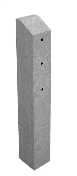

Use a concrete spur post
Wood will definitely rot at ground level - there's no question about that. So take steps to not only keep the structure intact when it does rot, but also make subsequent repairs easier.
Concrete spur post
Attach a spur post to the lower section of your wooden post, with 3 bolts through the holes as shown. Both the wooden post and concrete spur then go in the hole, and are concreted in place. You end up with about 50cm of spur below-ground and 50cm (the half with the bolt holes) above-ground.
Eventually the wood will rot at ground level, but it's firmly bolted to the spur so it still can't go anywhere. The wood above ground level remains sound, the spur is strong enough to stop a truck, and 3x M10 steel bolts will hold a lot, so the structure remains solid. And when (eventually) the post completely rots and needs replacing, all you need to do is bolt the new post to the concrete spur. The rotting remnants of the old post are still set in concrete, of course, but you can ignore them.
If you really wanted then you could even start with the wooden post slightly above-ground so that it doesn't rot off at ground level in the first place. This tends to cause problems with balancing the post-and-spur assembly when you're setting them in the ground though, so generally it's easier just to add 50cm to the post length you want and have the bases of the post and spur flush with each other.
Hint: You're much better using hex-head bolts instead of coach bolts into the wood, because you can't ever do up a coach bolt tight. Also use washers both sides to spread the load on the concrete and on the wood.
