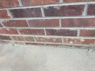

  1. They filled the weep holes with mortar/cement.
As you can see in there are gaps in the middle of every 3rd brick (now filled with mortar):

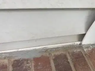

  1. Seems like they removed the original z-flashing above the brick, then sealed it

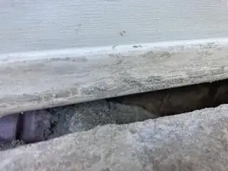

Up close to the sealed crack:

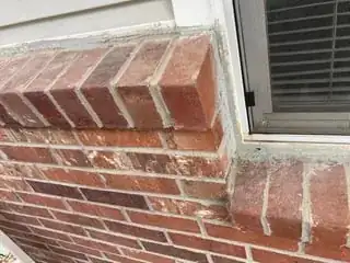

Near the window:

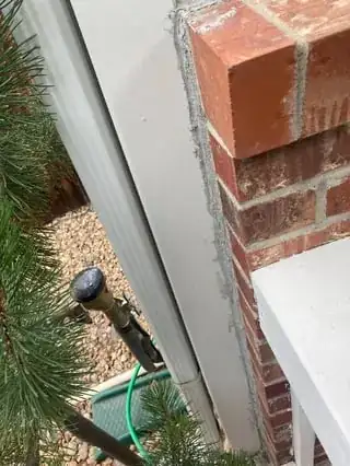

The side of the brick veneer:
I suspect there was once Z-flashing tucked under the vinyl and sitting above the brick veneer, however, if so it was removed. Then, It looks like they'd sealed the brick veneer to the actual wall (or possibly the vinyl siding) using mortar, possibly in the same act of sealing the weep holes. This makes me question what's behind the brick, i.e. flashing? Is there any space for airflow or is it just mortar? Then, when the brick veneer separated, they attempted to reseal it with polyurethane mortar sealant in pic 4.
  • Finally, after removing some of the sealant, I see that the house wrap was ripped away from the plywood sheathing.
Taken from the far left side of the brick veneer wall:
The pink tatter on the left is the remaining house wrap hanging down from behind the vinyl siding. In the middle is mortar/concrete. It looks like they filled the whole cavity with it. Way more than any would have broken off. On the right, you can see all the exposed plywood sheathing.
Seems like this happened when they redid the masonry. It definitely was not a result of me scraping away the sealant - I can see further along and below, and it's all exposed plywood sheathing.
