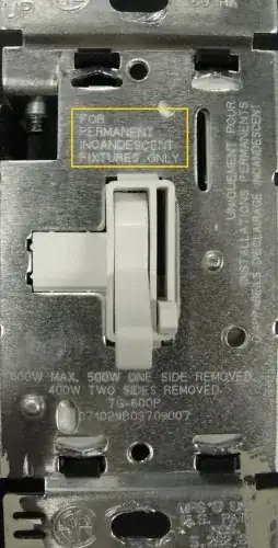

I have a ceiling fan on our bedroom's vaulted ceiling. Since we don't want 7' pull-cords, the speed is stuck at full-tilt, which is no good. The fan has separate switches on the wall for lights and fan on/off, though, so I tried putting a dimmer switch on the fan. Can that do any damage to the fan's motor, or is there anything else I'm not thinking of that could be a problem? I've noticed the fan makes a little bit of a groaning noise when I have the rheostat down, but since I've never heard the fan at slow speeds, maybe that's normal.

To find out if the dimmer can work with the fan, you'll have to inspect the dimmer. For this, you'll have to remove the cover plate and possibly pull the switch out of the box (in which case, make sure you shut off the power at the breaker). If you see the text "For Incandescent Only"; or something similar, you should not use this dimmer with a motor load.
Using a standard dimmer with a ceiling fan can damage the motor, and/or cause the dimmer and/or motor to overheat and cause a fire.

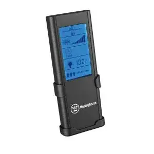

Install a remote control
If you're up for a bit more wiring, there are universal remote control kits available. You'll have to wire the receiver into the fan housing, so it's a bit more complicated than installing the wall control. But once the receiver is installed, you can place the wireless remote anywhere you like. There are a ton of these things available, so you shouldn't have any trouble finding one you like. You can even get a cool touch screen control, if that's what suits your fancy.
