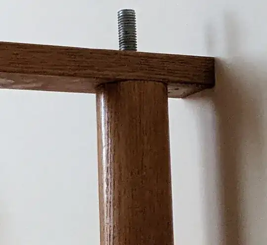

I am out of ideas on how to fasten this rail butting up to the wall. I don't think that using a bracket would give it enough strength if someone were to lean on it as its span is 6 feet and so there's a lot of torque. (Besides, a bracket would look ugly.) There is plenty of lumber behind the drywall (two sheets of 3/4 plywood) so there would be plenty of bite for a screw.

Any type of anchor/bracket at one end is not enough, unless there is more support along the length/other end. Six feet makes a good lever.
With good wood behind, a couple of good size screws driven into both sides should hold.
A bracket either under or on the outside will give more holding power. Brass brackets should look decent with that wood.
