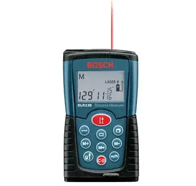

A story pole: You cut a piece of molding to just fit at the spot in question. Very accurate in a differential sense.
Used in brick laying, tiling, kitchen cabinets, when ever repetitive measurements from a baseline are used.
For gadget freaks, (like me) a laser measuring tool is fast and accurate, but you must write down and keep track of the measurementsenter image description here
