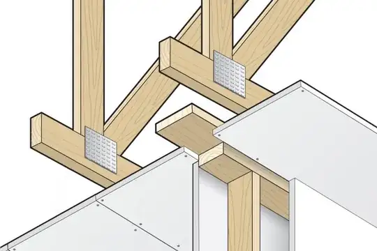

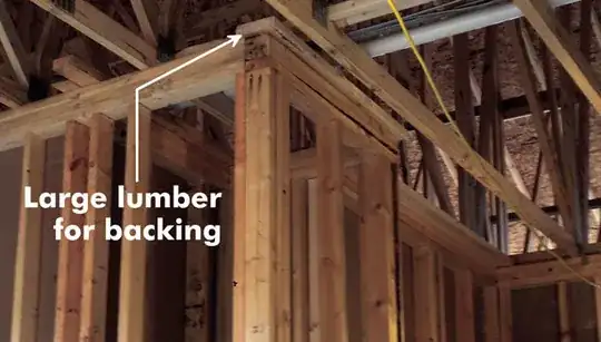

That's standard practice to create backing for drywall (or plaster lath) where walls are parallel with ceiling framing members. It's reasonable that the carpenter would've used extra subfloor material as it was readily available and of lesser grade (less expensive) than other material. It's also expected that several short pieces were used, as this is a good way to make use of scrap.
image source
image source
