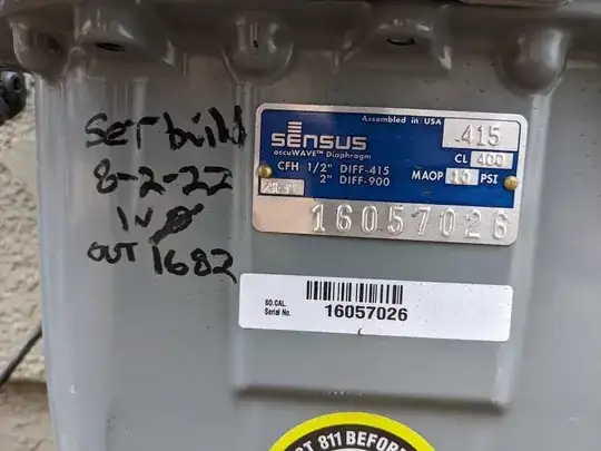

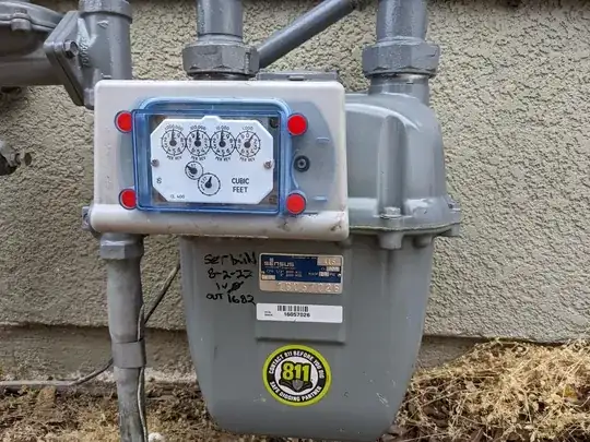

I was wondering if I could get a second opinion from the experts on here. Not sure if it matters, but I'm in California and I have a gas meter that has a 1.5" output pipe that gets downgraded to a 1" pipe before it goes into my house and through the attic.

Thanks in advance! Full Meter Image Close Up of Tag
