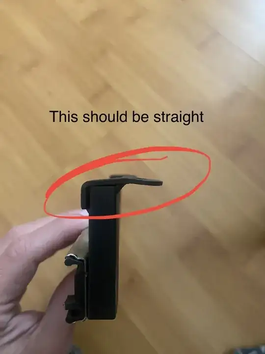

Metal bracket with bent arm
This is supposed to be flat, but got bent in a move. Because it is bent, it will no longer hold the trey properly. I have seen to use a torch, but the best I have is a candle lighter.
I have very little experience with things like this. I also have very limited tools, basically pliers, hammer, blow dryer, and I was thinking maybe the oven?

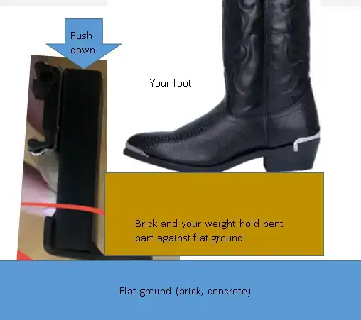

Bend it back
Here is how you could do it. Find a flat stone or brick. Use it to pinch the bent part against flat ground. Stand on the stone or have a helper stand on it.
The part on the handle will be sticking up. Gently push it down so it too is flat against the ground.
This will be more gentle and not mar the metal with hammer strikes.

Find a paver stone or brick high enough to put it on it
Put it on it and hammer it straight cold, not heat.
Try hammering from both sides
If you have one of those tiny hammer, it will not work.
Now to another possible problem. That is a design flaw. The large screw hole has left only two narrow stripes, weakening the construction. Now that is bend, bending it back might lead to failure (broken off piece)
