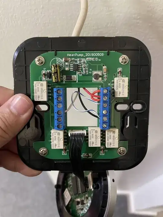

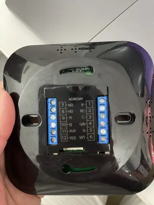

I do have the WiFi thermostat (picture attached) that I m trying to attached with my current central airconditioning unit but no success after trying multiple wiring. I does have three wires coming to the current thermostat (picture attached below)
Can someone help me if this exisiting thermostat can work or any other WiFi thermostat can work with the exisiting Air-condition
Same WiFi thermostat was working perfectly fine earlier in a different apartment.
WiFi Thermostat enter image description here enter image description here enter image description here

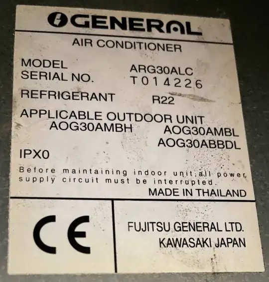

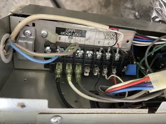

Installed Air Condition enter image description here
Air Condition Circuit enter image description here

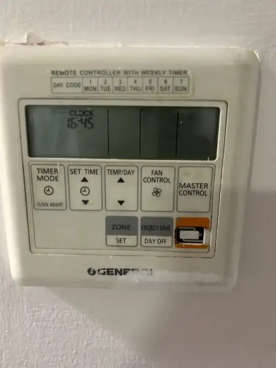

Current Thermostat enter image description here

You'll need a WiFi controller specific to your make and model of air conditioner
Your air conditioner is of a type called a "mini-split", which generally uses a proprietary protocol between the indoor controller and the main control board in the outdoor unit, instead of relying on contact closure signalling from the thermostat the way North American split systems traditionally have. As a result, you can't just buy any old thermostat and hang it off your air conditioner -- instead, you need a controller made to work specifically with your particular make and model of air conditioner.
