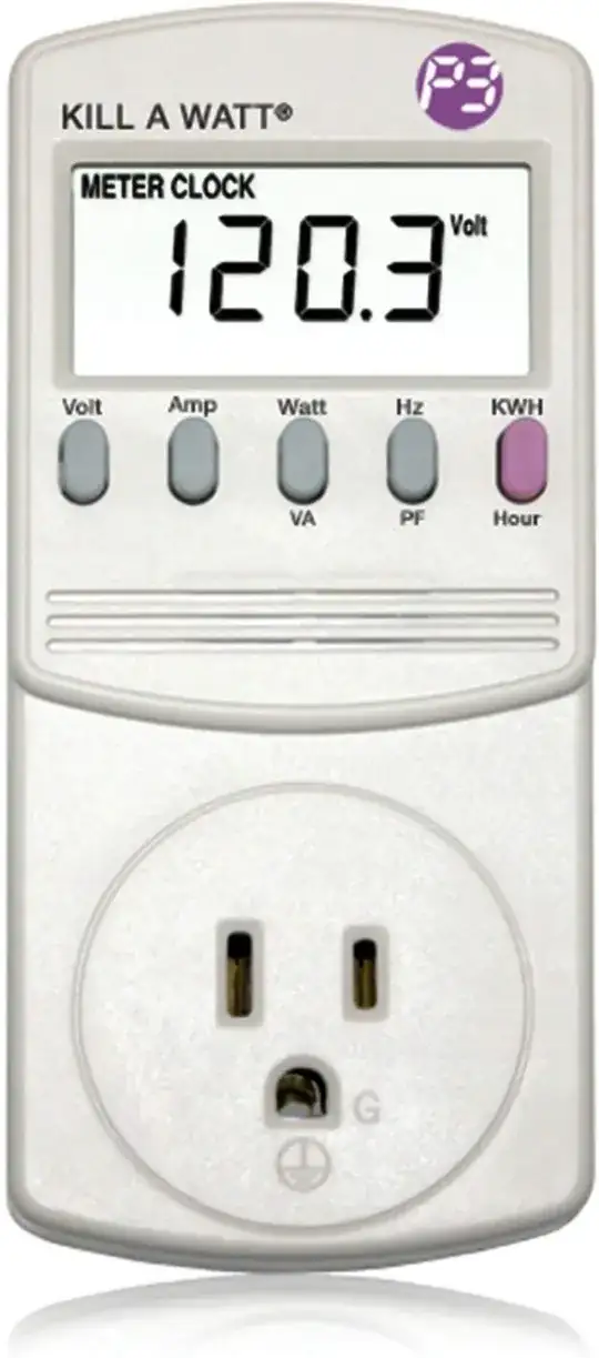

Kill a Watt
and use that to monitor any significant 120V plug-in devices. That won't help for your A/C, water heater, dryer or other 240V appliances. But it will tell you what your refrigerator and a lot of other things are using.
